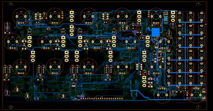

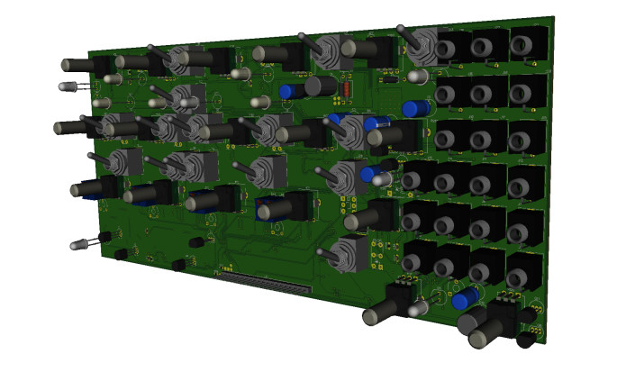

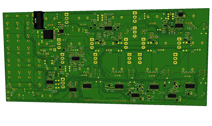

I had to completely rework the entire device because, of the large number of added features. This was hard, this A Million Little Fibers :D
but I managed to do everything.
3D render PCB
What has been added in the final version:
- all previous improvements
-Standardized size to 48hp, or 242mm x 128,5mm.
- All settings are available without disassembly. Added holes for access to trimmers. (4x osc tune 1v\oct trimmers, lfo rate bias trimmer, out max voltage trimmer)

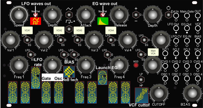

And very important addition:
A large number of opportunities requires more control. A transparent acrylic panel very nonstandard, but many do not like screws as pads, and because of the large number of holes decreased panel strength. I worked on it.
And designed a new panel, at the core of the PCB.
Light indication of the work is saved through the gaps in the PCB. For the convenience of playing in the dark, all pads will be highlighted.
Where:
Pads OSC\LFO have 3 zones. Top,mid, bot mid +top= frequency up, mid+ bot=freq low. For gates Pads mid + top=gate open, mid+bot gate closed. Eg Pad launch EG work. Impulse time = Hold Time.
When the panels are ready, there will be an additional video about it.
All pads will be covered with immersion gold (ENIG)
What is now ready, and what's next.
Now, during two days,it's very important for me to get feedback from all the backers. Do you agree with the new panel design. Acrylic panels are also available, but I think it's a step back. As soon as the problem with a new design is solved, production of panels and pcb's will start immediately.
