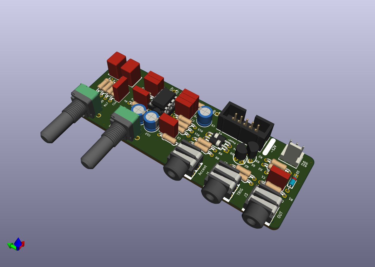

I've done all the "gerbster" modules in eurorack skiff style. There are errors in he's schematics and a few unnecessary add-ons (at least in my opion), so beware. I haven't released anything yet, since I want them to be error free, but here's a FB live video with line out audio.
..and here's the whole TR-606 in 5U format, with mixer and gate to trigger -shapers for all the drums:
ps. I also didn't get any reply from gebster..

JanneI wrote:I've done all the "gerbster" modules in eurorack skiff style. There are errors in he's schematics and a few unnecessary add-ons (at least in my opion), so beware. I haven't released anything yet, since I want them to be error free, but here's a FB live video with line out audio.
Oh, that 5U PCB looks freaking amazing!
If you make a run, I'm def. in for a set for sure!
I'm not into 5U, but that is really easy to mod it to a desktop thing.
Are the published etch layouts have those errors as well?
I only used schematics and compared them to the original, no idea if the etch layouts are correct or not. But I try to make some final adjustments and release the gerbers and schematics. Hopefully before christmas :)

Post by Barcode » Fri Sep 14, 2018 4:37 pm
Well crap... I've been working on single board version of the gerbster 606 also. Euro and desktop friendly...
What were the errors you found in his schematics? I haven't dug in to far but I found that some of the pot pins were incorrect.

JanneI
Posts: 364
Joined: Mon Oct 19, 2015 3:28 am
Post by JanneI » Sat Sep 15, 2018 1:13 pm
Here's a couple pics more of my TR-606 eurorack modules:
