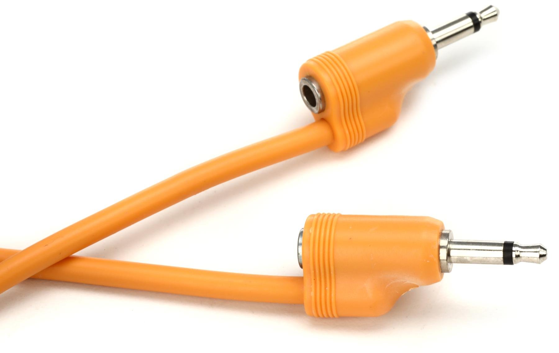

There are two reasons to avoid stackables. They are expensive for their high failure rate and they put excess leverage on your jacks.
If you stack two or three cables into a single jack you are creating a cantilever on the inside of the jack from all the weight that is extended from the panel. This creates more leverage inside the jack potentially leading to premature failure.
The other thing is stackables have no strain relief which is why they fail.
Look at this picture:
Notice where the cable meets the jack there is nothing there.
Now look at this Alibaba cable which *does* have strain relief:
The second one will last longer than the first. By a lot. I bought about 50 stackables when they came out. All but two have failed.

I don't like that style of floating mults. I've got a couple of cheap star mults that work, but they wind up dragging on cables and/or sitting on something, getting in the way.
There is NEVER a reason to stack three things into one jack. Think daisy-chain, not star configuration. If you regularly need to connect more than 5 things you're probably better off with an actual mult, possibly buffered.
My cable experiences:
Modular Addict stacking cables: I own 15. 0 failures
TipTop Stackables: I've owned about 8. 0 failures
Control BT: I've probably had about 30 of them. 0 failures, but the kinks never fully worked out even after two hot water treatments and hanging for months.
Control Crono: I've got 10. 0 failures. They have minimal strain relief, but they're also short.
Erthenvar: Probably about 30; 4-5 failures or DOA.
LMNTL: Probably about 25? 0 failures.
Make Noise: A few from the 0-Coast and 0-Ctrl, 0 failures, but I haven't used them that much. The stacking cable included with the 0-Ctrl is identical to the Modular Addict ones.
Modular Addict braided: I had about 35, 0 failures.
Modular Addict skinny: I own 55, 0 failures. They have no strain relief
Polar Noise: Bought 10, one was DOA.
Tendrils: I have about 10, 0 failures but most of them have been very lightly used.
(Why so many? I had a mishmash of cables at first, trying to find ones I liked or ordering a few at a time from wherever I was getting modules. Then I went all in on Modular Addict braided and stacking cables, and sold off most of the menagerie. When I switched cases I decided I wanted thinner cables so I went for the MA skinnies instead. Tried Tendrils to see what I thought and for some specific connections, and got the Polar Noise because MA was out of stock when I felt like I needed more 12" cables.)
Treat your cables and jacks well -- hang them up for storage, don't yank them out by the cords.

you can reduce the strain quite significantly by daisy chaining alternating stackcables and regular cables- for example stackcable from Marbles Y into Plaits Timbre - regular cable from stackcable in plaits timbre into stackcable in jove resonance and the other end of that stackcable into something else

Regarding stackables, I agree with others: these risk creating high-torque situations that will ultimately weaken the solder joints of PCB-mount jacks! Everyone hates broken stuff, but there's actually one thing that's a million times worse -- intermittent[/] stuff. So save your pennies for active mults -- you'll never regret having more buffering than you really need!

Get stackables; daisy-chain them rather than stacking multiples sky high in one Jack, take care when unpatching that you don’t just yank them around and store them sensibly. I have used loads of the things over five years and not one has failed.

Have had failures of every brand of cable. If you haven't ever had a failure, it's very likely your sample size is too small and your usage period too short.
No one has addressed the fact that stackables do *not* have *strain relief*. This is a very important feature, and all of my stackables that failed, failed at this critical point. They are engineered wrong. Plain and simple. Caveat emptor.

Post by Schrank » Fri Jul 24, 2020 5:02 pm
tuj wrote:
Fri Jul 24, 2020 5:12 am
Tiptop Audio reacted to the high failure rate of their cables and improved the design. They are very reliable despite not having strain relief. I have ~35 Stackables in use since about three years and not one has failed so far. I hope they won't fail for a long time because yes, they're really expensive.
Also, like Starthief mentioned, there is no reason to stack more than two cables and from stacking two plugs high, the jacks of a module won't break.

Post by Yes Powder » Fri Jul 24, 2020 5:18 pm
Stackables are much better than they used to be. They shouldn't be your primary cable and definitely don't go making towers out of them, but they're nice to have.

Post by pekbro » Fri Jul 24, 2020 5:36 pm
I have one pretty complete (length-wise) set of the hosa version of the stackables,
they work fine when I want to use them, which is hardly ever. I just use a buffered
mult or make multiple identical versions of the source signal. Mostly the modules I
would use them for can already output multiple identical gates or whatever anyway.

Post by Multi Grooves » Sat Jul 25, 2020 6:52 am
Agawell wrote:
Fri Jul 24, 2020 7:36 am
I remember the days when people used to just recommend counting up the jacks on the modules and dividing by 2 - which works for newer users quite well - as you get more and more modules - it's likely you'll need fewer cables per jack as you will be less likely to use all modules at once
If you are going to get some stackcables - and they are really useful - then maybe 20% of the total should be stackcables
this will mean that you should not run out of patch cables until you expand
it's also a good idea to buy a few 1/8" to 1/4" cables - just in case you need to interface with something else
I've found the 3.5->6.35mm mono adaptors also fine.
